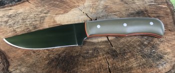

Here's one I'm calling a "field skinner," aimed squarely at field dressing. That's the #1 used game knife in my neck of the woods. I've attempted to put a knife together with good "reach" for internal work and well suited for precisely separating things than need separating. I'd love to here your thoughts on what you see.
Looks good to me!
What are the dimensions and what did you use to darken the blade? I like the overall shape and the fit and finish on the handle is well executed. The shape of the blade is well suited for an all around hunter in my opinion.
OAL 9." 4 1/2" scales. Cutting edge is exactly 4." That leaves about a 1/2" between the front edge of the scales and the start of the edge. That is intentional, but I'm still trying to decide if it's a feature or a flaw. ;)
That is just a reflection of the tree above the knife that makes it look dark. It's a bright medium satin finish. Here's a better pic with my sausages wrapped around it for better reference. B971FB22-EFCE-4EB9-A75D-EB9F33115318.jpeg
That is just a reflection of the tree above the knife that makes it look dark. It's a bright medium satin finish. Here's a better pic with my sausages wrapped around it for better reference. View attachment 69259
IT really looks nice. The only thing I would suggest is a makers mark! Beautiful work.
