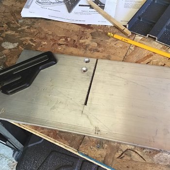

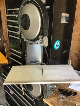

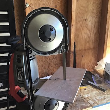

I bought the HF Bauer Porta Band saw. Got it on sale for 100 dollars. I took of the little black guide and used a piece of 1/4 inch flat aluminum 6 x 12 for the table. I cut a double kirf width wide channel in the center to accept the blade. I hope that is enough not to bind it. I drilled two holes with countersinks to accept the same screws that the saw came with that attached the black thingy. I will utilize the bench vise to hold it. I know realize I do need a pice of Velcro or something to keep the trigger pressed.AEBBBCEC-2C19-4C28-A6F8-72C3FABDF8C9.jpegE3B12191-FFB7-407F-A247-8CBC1EB87BB5.jpeg

Looks good, but turn your table around so the slot is to front. That will allow you to change blades without removing table. I did my table like you did with slot to rear, didn't take long to decide I wanted to turn it around.
Another volt for the foot switch - a real handy thing.
That makes sense , I wish I caught that. It took me an hour to triple measure to make sure those holes lined up. I didn’t want to make a mistake and have to re drill holes. So much for that.
