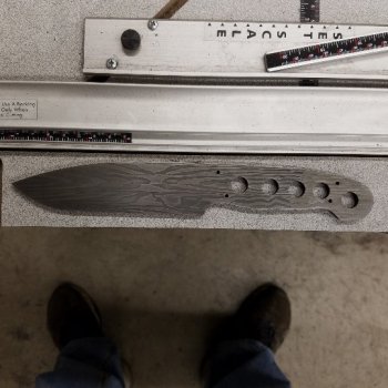

My girl friends son uses his grandfathers hunting knife. He commented that he would like to put it in a shadow box and save it. There ya go. You know what is coming next. Mama wants me to make him a new knife. Being a good boyfriend it did not go any further then,, YES BABE!!! I started with a "M" pattern. I don't think it turned out very well. Next time will be better. It's still a keeper. I'm down to .187 thick. I think I should thin out the belly some. I have a choice of scales. I have a nice set of Iron wood slabs. Any suggestions would be nice. I'd like it to be the best I can do. Will the hunters please step up to the plate!!!

First off... I love the handle! I’d go thinner than .187.... .125 is pretty nice. I would also make the point a little pointier. When removing the skin, it’s nice to stick the point under the skin on the legs. I know that I’m not making much sense with the description... it just has to be very pointy. I like the design... he should be able to chop, skin, debone, and slice in style with this one!
Kevin I'm not a hunter. I go to Cub. lol,,, I read here that to thin of a blade would not be good. I think 3/16 was mentioned. I could be wrong. I think you posted on that thread. Changing to .125 is a easy fix. I can pull the tip back too. When I looked at hunters at Cabelas I found one similar to the one I made. I copy!! Thank you for your help.

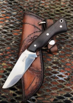

The dropped point is great for not busting the intestines when you field dress the animal. However, even though it drops, you can still make it a sharp point. I am, in no way, a knife design expert... these suggestions are coming from a knife user’s perspective. Here is one that I built. I still need to go back and make the point even pointier.

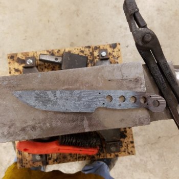

I just asked. He field dresses and takes it in to the butcher. I might have to fire up the forge and straighten out the front of the blade a little. It's still .187 thick. Plenty of material. I need the practice anyway! lol,,,
That didn't hurt to bad.

I like that blade shape better than the initial. If he's using it for field dressing he will need a sharp point to get under the skin and that nice big belly will take care of the rest.
I think your right Jeremy. I might thin up the belly just a little. I have a file I have not used yet. It's for putting thumb groves on the spine. I'll give that a shot.

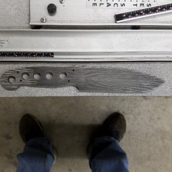

That is a much better nose than the first incarnation. If it is just to field dress then a slightly easier belly is better as he will have to get the knife inside the animal and a larger knife is clumsy in there.
As far as designs go the one on the left is a dedicated skinner and you can see the relationship between the nose and the start of the curve. There needs to be enough of a slant to that conjunction of nose and belly that it will slce as it is put under the skin where if it is too flat it is much harder to open up down the legs etc. The knife on the right is a compromise hunter skinner where there is not as much belly so the transition to the nose is easier but there is still enough to be decent skinner.
