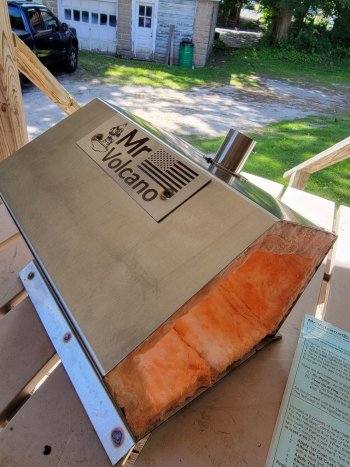

Gliden07
So I've been working on piecing together my forced burner forge. In the meantime I needed something that I could just run for a bit. I didn't want to spend 3-400 bucks so I ordered a Mr Volcano single burner forge! $75 delivered to me off of Ebay! Got it today and have to admit it's a lot nicer than I was expecting!! Forge body, hard firebrick for floor, Burner with shut-off, 20LB regulator, KAO Wool, rigidizer, 2lbs of Satinite and the Cherry on top 2 laminated instruction sheets! It's all Stainless Steel too. The couple things I'm not fond of, regulator has no provisions for gauge and the propane hose they provide is slip fit on the nipple of the regulator (I have some real hoses and regulator to use instead). I have the Rigidizer on the Kao-Wool set oven at 200deg brought it up to temp and put whole forge in then turned it off till tomorrow. First coat of Satinite gonna go on then the second and I planned on top coating with ITC100 and getting some Firebricks for the ends to conserve some fuel. I'll reserve my opinion until I use it a little. But if it works as good as it was packaged and thought out it seems it would be a Fantastic beginners forge! To be Continued!!

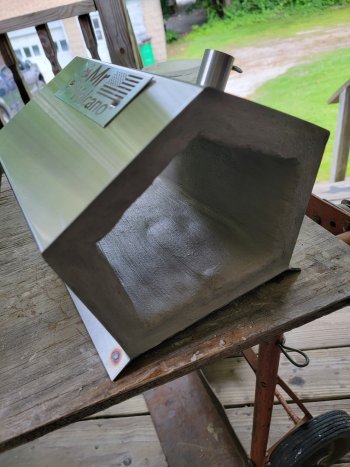

Gliden07
Second coat of Satinite! Couple 3 days dry time and then ITC coat! Will see if this thing works or not?

Gliden07
Relined with a thin coat of Satinite, waiting for ITC. Plan on putting hard brick back in and filling in the edges with Kao-Wool cover with Satinite to help with swirl effect! Hopefully be able to hit welding temps??

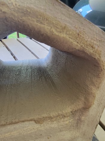

Gliden07
Well here is the interior of the forge with the hard firebrick molded in with the Kao-Wool and rigidizer applied. Like everything with a forge have to sit and wait for it to dry and then coat with Satinite and ITC!! Hopefully the molded infillets will help the burner in this chamber swirl and I'll be able to hit welding heats with it??

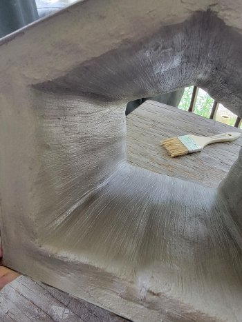

Gliden07
First coat of Satinite on at least 1 more to go then ITC100. Figure filling in the gap from hard floor to wall will help with to swirl the flame?? We shall see!! Forges are such a PITA to reline!!
KenH
It's sure looking good. I do think it's going to really work nice. My first two forges with venturi burners and worked good. BUT, since I changed to a blown burner, I wouldn't wish anything else.

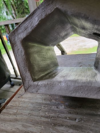

Gliden07
I know it all looks the same LOL!! But trust me second coat of Satinite and 1 coat of ITC100 on the Satinite. Everything always has to wait to dry! This is so tedious!! We're getting close though! Do I need more than 1 coat of the ITC?? It's been so long since I applied it I can't remember what I did!! LOL!!
KenH
Looks like it's burning nicely. I don't think you'll have any problem getting to welding temps with that forge. You might have to move the billet back 'n forth to get even heating from end to end. There is a nice swirl pattern around the forge. Good job.
