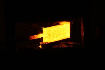

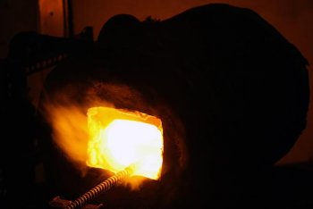

Well, This is our third forge. and a dedicated super duper welding deluxe WELDING forge! Both of the other forges we have are atmospheric set ups and have served us well. The last one was a little rocket and worked great.. But we are wanting to start working with stainless and making some stainless damascus and stainless clad billets etc, etc. and needed to upgrade to a forced air forge!
After a full day of fabrication and weeks of preparation we fired it up for the first time today and tested it out.. Welded a 30+ layer stack. Im a happy knife maker!! Now Randy Jr. can start making us some EVEN cooler stuff to play with!
Anyways heres a few pics of the forge and the first weld!! :) Yea, I know most people take pics of the children and stuff like that.. I take pics of steel nd forges and sparks flying! lol Its a KNIFE LIFE!

What are you using for the air supply? I would like to see pics of the whole thing! Looks about like mine. I do like the cart you have it on.
Im using a 1 HP blower as my air supply. Hard wired with PVC to the intake. It sets on the bottom shelf..

How big is your door? And did you do the same for the back? When I built mine I had a time getting it to tune with the doors on (they are 4"), I had to take the doors off, and it runs great, also what size is your burner? I am so
indebted to Ed Caffrey, he held my hand through me building mine, gave me the confidence that I wouldn't blow myself up! I went with a 1"burner tube, but got to thinking about putting a smaller nipple on it, to see if it would increase the heat, I finally got a pyrometer so I'll know how hot it's running, and I think I have it wired well enough to
drill another hole for it to sit in. I recently went back and fixed some errors of my design, I just didn't listen to everything I read, or I thought that what I had in mind would work better, I was so wrong, I fixed that, and it's running pretty good, haven't tried it with the doors on yet, I might give them a shot since I fixed some of the other problems. Thanks for sharing, it looks great! Rex
Rex, Yea. the doors are not a problem on ours. I ran a 3/4 inch burner. and the doors are 4+ inches across and 3+ inches high. Front and back. :)
I used the Zowada style burner.. Which I modified from the original plans. But same basic concept.
Ed is a good guy, and has helped a bunch of folks in getting set up. myself included. :)
Will be interesting to hear if a smaller burner works for ya. I dont have a pyrometer on this forge. But can say without a doubt its hotter then any of our other forges.. MUCH HOTTER!!!
