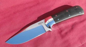

You can either go to higher grits when sanding and a light buffing or try sanding to somewhere between 220-400 and a coat or two of Tru-Oil with a vigorous rubbing in between coats. Another alternative is to wipe down the Micarta or G10 with a gun cloth (with G-10) after sanding to whatever grit you choose, that perks it up pretty well.
Canvas wiped with a gun cloth.
Rudy
