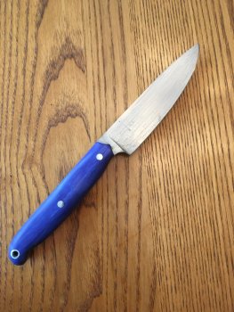

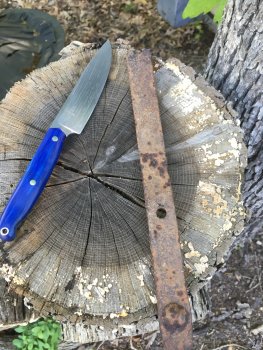

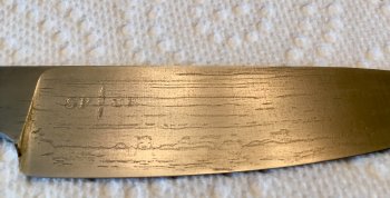

I forged this blade from part of an old plow I found out in the woods. Not sure what type of steel it is, though it produced a fair amount of sparks while grinding. After etching, I ended up with this curious pattern similar to Damascus though there wasn’t any other forge welding done. Anybody care to comment on what the wavy lines might be from? The blade is plenty hard and sharp.

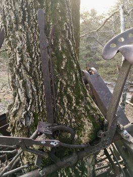

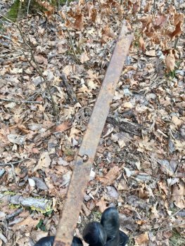

Interesting. Could high tensile steel produce those markings? The plow is probably over a hundred years old. A tree had literally grown around and through parts of the plow!

That knife has great lines and is overall a nice job. The blade looks de-laminated to me (once again I'm not a forge guy) but apart from that everything is super clean looking.

I think your knife looks really cool with the "layer lines". I have no other guess except for Old Wrought Iron due to the age of the plow. There are others on here with way more knowledge than me though. I am sure they will be along shortly...

That's what I was thinking, but I've been looking at other knives on the web made from wrought iron that shows the same wavy lines. Those also had some serious pitting on the blade, which mine surprisingly do not have. I've tested the edge by chopping and hacking through 2x4's and there's no chipping and rolling of the edge. It's also sharp enough to slice through the proverbial piece of paper. The question remains how long will it hold the edge. That could be doubtful with such low carbon content. But it was a fun project and a cool looking piece to show "before and after."

Take a piece of the same steel and heat it to non-magnetic then quench it in water. See how hard it is to break, that will be the best test short of a scanning electron microscope to tell you about the carbon content in hot dog steel. The "wrought" thing was just a guess based on the appearance of "layers" and the age of the plow. Also, the plow may have been "fixed" on the farm with whatever steel was lying around. There were not too many tractor supply stores around 100 years ago so farmers often had a small forge set up for just such occasions so they could fix stuff. So even if the piece would have originally been one kind of steel or iron it could have been replaced. In any case, it is a cool knife and a great use of steel that would sit and rot otherwise.

I would think that it's wrought steel, basically wrought iron with enough carbon in it to harden. The stripes that you are seeing would be strands of slag. Just my guess, anyhow.

Looking at the original metal, I'd guess wrought also by the way it seems to have torn on one end and the severe bands of junk.
