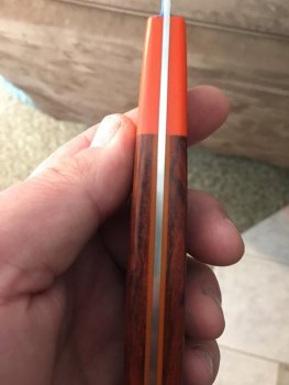

If you ever figure out how to make orange liners orange, let me know please. I've made a few knives with orange bolsters and liners and they don't match. The same goes for red too. Great looking knife!
Self Made Knives
Here are a couple more pics, and I agree Matt! The orange G10 liner was a let down, it ended up kind of brown looking. I've used the dark red fiber liner and it seemed keep it's color better. To second Matt's comment, is there a way to get a bright hunter's orange liner?

Matt de Clercq
I've tried using it up to .063" thick, coloring the apoxy, hand sanding with clean paper, putting WD40 on it and sanding all the way to 2000 grit. The only other thing I can think of is going to a .090" liner.
