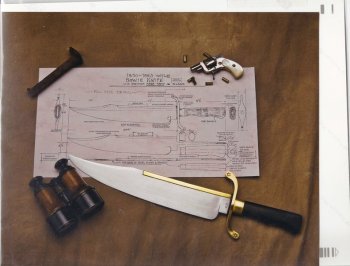

MUSSO BRASS BACK BOWIE AND PART OF MY COLLECTION

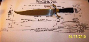

Pathfinder was nice enough to send me a drawing i been working on most of the the summer this what i com up with.
This is my version . The blades is made out of buggy axle steel.The guard and the butt cap is wrought iron.Handle is figured mesquite wood . I cold blue the blade.For the guard i forged the wagon wheel wrought iron the slotted the guard marked where i wanted my bends then hot forged them in for i can have the wrought iron flow better.

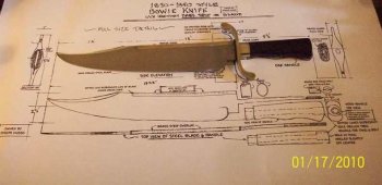

When I stumbled on this thread, I read the first lines and immediately sent Pathfinder an email requesting one of the drawings. I then proceeded to look at the date , read the rest of the responses and realized that he had given away all of the drawings.
So I sent him a message through Knifedogs and I apologized for bothering him at this late date.
He was kind enough to respond, acknowledging that all of the drawings were indeed gone. But then, he mentioned that he had a smaller drawing printed on parchment. He asked if I would be interested in it. I nearly wrecked my keyboard trying to write an email to him saying YES I wanted it.
He packed it up and shipped it to me and it arrived yesterday in the afternoon. As you guys can imagine, I was checking that mailbox often. I looked in it, in the morning before I went to a friends house to help him a little.
As soon as I can, I am going to have a one to one full size drawing made of it and the parchment one will be framed to protect it.
Pathfinder, my heartfelt thanks for this beautiful gift!

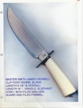

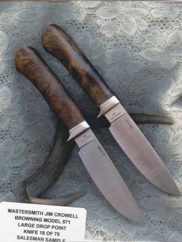

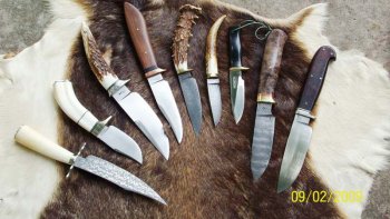

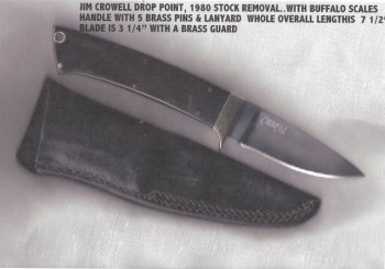

Very nice collection! As an old style guy the Musso Bowie is my favorite! Really like to have a copy of the working drawing.
Thanks for sharing!!!
