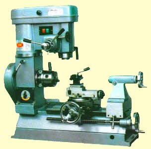

I just bought this on craigslist , I love it mill/drill/lathe mine was$300 it was 463lbs it was hell getting on the table its on did it by myself:eek:
I have that machine. I bought it new from Harbor Freight. It's an OK mill/drill/lathe but not great at of them. If I had it to do over I would buy a dedicated milling machine.
One thing I immediately ran into was that I didn't like the drill chcuk for milling. I replaced it with collects but then the milling head would not travel far enough to meet the vise. I had to make a riser to raise the vise.
The milling motor burned out after about 2 years of moderate use. I got a replacement motor from Harbor Freight for $73 which wasn't too bad but I thought the original should have lasted longer.
