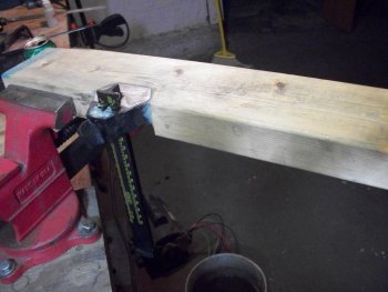

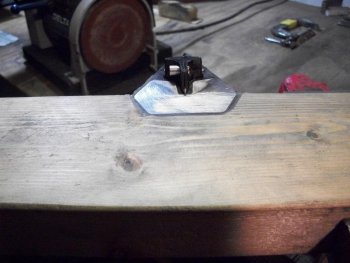

heres a1.50 hight gadge i made from a wood mortice scribe at least the guy at garage sale called it that then placed it in a sanded flat 2/4
