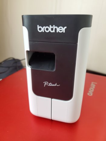

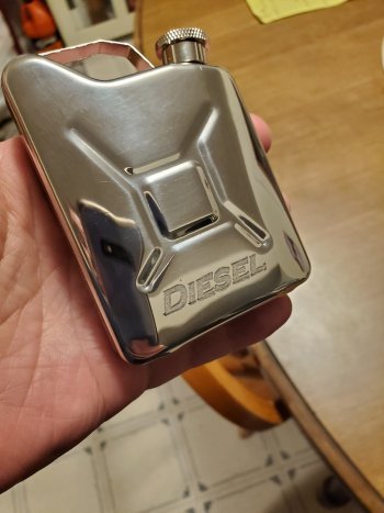

Gliden07
Depends on your etcher too. The more power the more heat the quicker they degrade. I've been using the same ones I bought 3 years ago from Ernie. I just started making my own stencils with a Brother printer. Those stencils are not going to last more than a few uses per stencil. I did it for fun and figured I could offer my customers custom 1 off stencils.
Jon Buescher
what printer is it that you use?
Gliden07
I cant remember the exact model it is a 7XX model. I'll try and find the paper work for it. GF moved it somewhere for some reason only known to her!! LOL!! But this is a pic of it. It has to be used with your computer and a free software download. Second pic is a Gerry Flask I etch and sell using the Stencils I made with this label maker.
