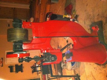

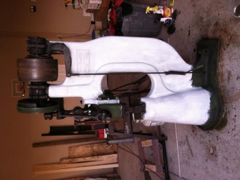

I finally picked up my first power hammer, a 50lb little giant last week. I got a smoking deal on it that I just couldnt pass up. I found a nice 3hp baldor motor to run it along with a double groove pulley for 2-belt etc. What I wanted to get some help with was mounting the motor. I have seen the kit that is sold for mounting the motor on the frame and wanted to try to make my own. What im an a little unsure of is what to use for mounting points on the frame. I see alot using the spring bolt for the peddle being used to attach a support arm, but short of that bolt I dont have any other holes/bolts on the frame to go off of like I have seen on other machines. Im extremely nervous to drill into it and would rather avoid that. I have seen some people mount the motor on the wall next to the machine with a hinged shelf so the weight of the motor keeps the belt tight, or building a stand next to the frame to support the motor. Im just unsure on how to mount the actual steel to the frame the motor attached to. I have attached a few pics of my hammer to help get a visual. Im getting there with finishing sealing and painting (its not finished in the pictures), and i want to have it all done and running this weekend so i figured I would ask for advice before mounting the motor this weekend. Thanks again!
Stripping off years of grease and build up took me days!!!
Prime and sealing
Painted angle 1
Painted angle 2

very nice job . I had a chance to buy 25lb a few months ago and it was in too bad of shape . you did a stand up job on that one . I would be proud.....
Thanks so much, it was sitting in a barn in upstate new york not being used, I could not believe how hard it was to get the mix of grease and black dust mixture off of it. It literally took about 3-days and a couple big bottles of degreaser and a scraper, you can see the piles coming off in the picture. I didnt find out till about a day into it that it was actually painted green! lol so anyway, yes I have it looking nice, now that the motor is here i need to get her running.
