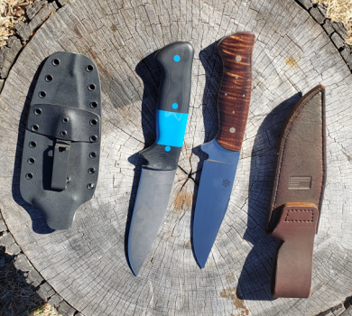

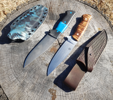

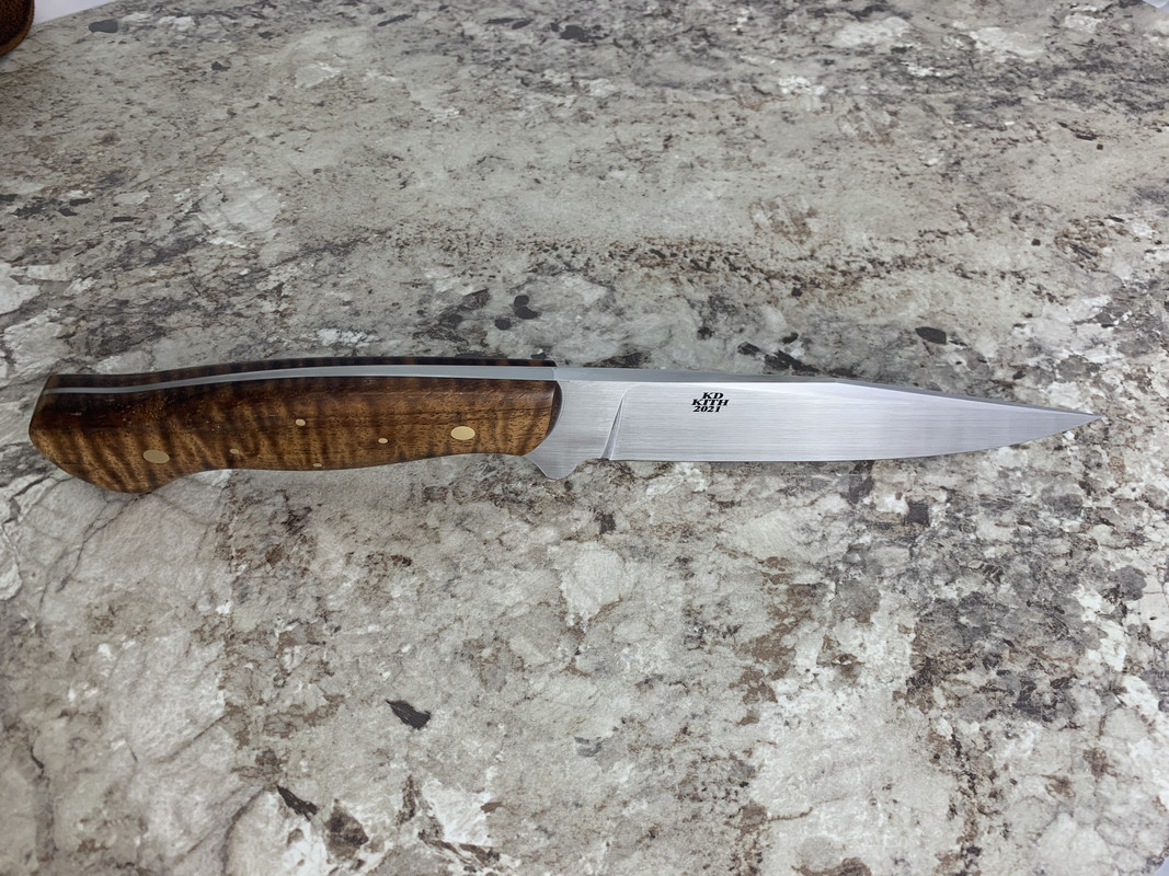

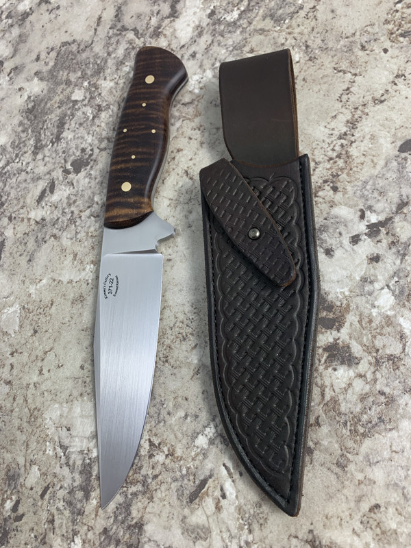

Kaleb and I exchanged KITH knives last week, so I thought I'd post pictures of the knife I finished.
I used a piece of curly Koa (Is anyone surprised at that?) for the handle, fastened with 2 corby bolts and 4 3/32" pins in a diamond pattern.
On the sheath, I stamped a basket weave pattern. I had to practice on 2 others before doing this one as I haven't done this stamping before.
I'll let Kaleb post pictures of his, but I have to say, I was super impressed with the knife I received! It was interesting seeing how another maker made the same design but did things differently.

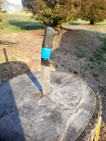

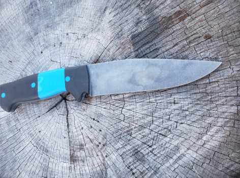

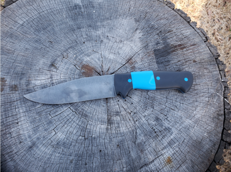

I am a little bit late to post this, I apologize for that. Anyways, this is the knife that I made and sent Gene.
I used G10 for the handle and pins. I used a blue piece and sandwiched it between two black pieces. I then put that sandwiched bit on a piece of blue G10 liner.
The sheath is made out of Kydex. I pressed the kydex to the knife, shaped it and then added a clip on the back.

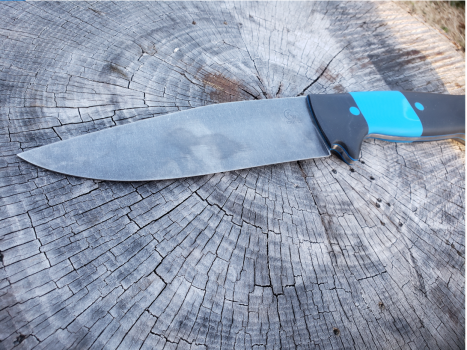

The blade was hand sanded to 800 grit, then dipped in FC to turn it black. I then stonewashed it. It has an odd coloration on the blade, I am not quite sure what happened, but I have it happen every now and then when stonewashing.
My logo was etched in with electrolyte and a car battery charger.
I did not have any photos of my knife with the sheath, so I included the ones that I have of the knives together.
