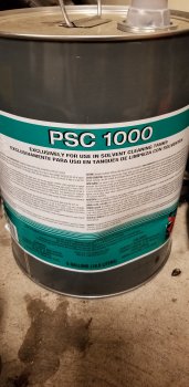

Benjy
Chris, I have an offer for you, why don't you get 5 or 6 billets ready then drive up here one week end and we will use my press to squeeze them together. After you get that size billet to welding heat it takes 10 seconds on my press to complete the weld.
Benjy
Yes, that is what I am using, I believe kerosene works the same. But this stuff comes in a cool can. Hahaha!
