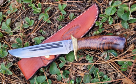

40 yr old wood in this handle...Walnut also. It looks like you have English and Claro there. The handle in my pic is Claro. worth the trade!
