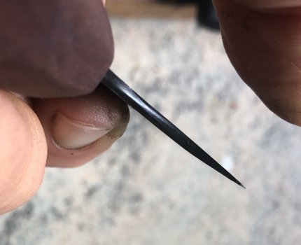

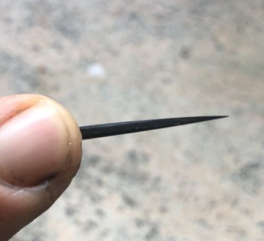

1. that choil shot from a commercial honesuke is quite a bit fatter at the edge than i usually see and make. For a custom i would go for sharper as you have skilled user.
2. i zero grind as per that diagram, and put a micro bevel on each side. the steeper one on the 30 side, the shallower on the 70 side, it is not critical, but that will cut closer to the bone, if you put that 70side bevel flat on the bone.
3. honesuke usually has a flat-ish ura. and flat bevels. i think the grind gets rolled o the wheel to achieve this, or it gets polished to flatten the bevels.
4. honesuke the spine tapers quite a bit from heel to toe, so the width of the bevel often becomes more narrow towards the tip. if i use1/10thstock i don't taper the spine, as it is already a very fine point, some might see this as a mistake. conversely if i do have a tapering spine, i blend the bevel from heel to toe, so that the bevel appears the same width, which gives an even finer point, which may or may not be desirable... but i dont like the look of the bevel narrowing to the tip. whatever you do sturdy heel and fine tip is important for honesuke function. on thin stock i often widen the bevel to the tip, on a non tapered spine, to accomplish this, and sometimes i fudge it so that it does this even though the bevel appears to be the same width throughout...

Andre Grobler
Heel and tip shot, this is a 60/40 and i somewhat convexed it, in 15n20c it will go through most of the chicken and rib cartillage without damage… so plenty sturdy
