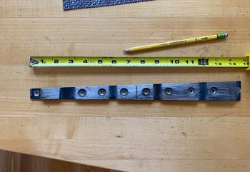

As some of you know I am making a knife handle out of U2 wing skid plate for a veteran per his request. I would like to soften and most likely need to soften it . I read that I get it red hot then quench it. I read that quenching doesn’t harden it like carbon steel. Is this the right process?

Yes it was confusing. I tried to use a simple solution that someone mentioned. Didn’t work. Cutting it half was no bid deal with the angle grinder. Slow but it did cut. Trimming the sides of onto get the same wi was hell. I just kept biting at it with angle grinder and the 40 grit on the belt. Finally got it really close. So I will include these on the handle of the knife.,somehow. I still have to design the knife. I have some ideas. Interesting note. Those scratches are not from the wing of the U2 plane tilting and the wing skids on the ground, hence needing a skid plate. I didn’t know the plane on,y has two wheels like a bike, so obviously as the plane slows down the plane will tilt one side depending on which wing has more fuel. 9C1A42EE-D598-4106-B26D-44592A15EB29.jpeg4C12DD60-9EB4-46CC-9C0F-45851BC06742.jpeg
