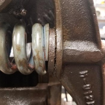

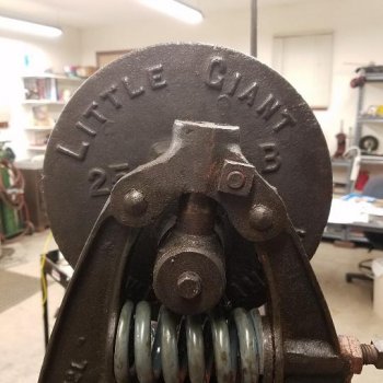

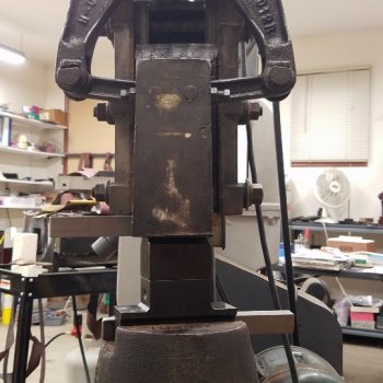

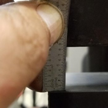

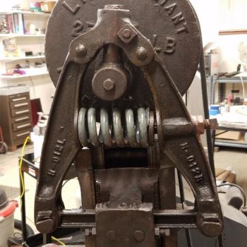

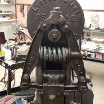

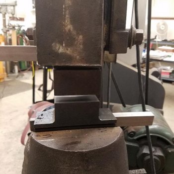

I got the old dies out. I can honestly say,,, sawzall's are good!!! lol,,, I sliced the keys in half. I got the new dies in and spring. I know from my info from LG they are looking for 7/8's to 1" gap between the top and bottom dies. Well that's not working so well for me. I got 1/2". The cross head is as high on the pitman as it can go. The only other adjustment for ram height is the adjusting screw for the spring. That will work great except it pushes the plate that holds the spring away from the arm. That is what gets my attention. Is that right. Should that be about 3/16 to 1/4" away from the arm???? It was not like that before. I know the bottom die is better then .55 taller then the old one. I did not bother to check the top. I can only guess. The old dies might be 73 years old?? That's what I got going. Is it ok to have a gap better then a little between the spring support and the arm. Thanks for your help.
