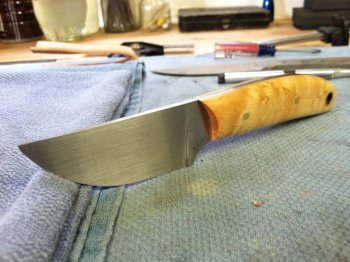

I've been trying new techniques in applying epoxy so that when I clamp the handle scales to the blade it does not squish out forward into the finished blade area. The last two knives I made I did a pretty good job of it but yesterday I did one in the same manner, except I added liners (more epoxy) and squish. After I pulled the clamps I spent the next hour picking epoxy off with an x-acto.
The knife came out fine but I wondered what pointers you guys have to avoid this?
