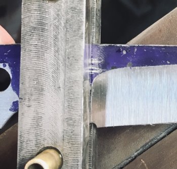

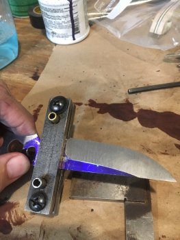

Everyone has been there and done that... chased the plunges right off the ricasso. This is where a super simple file guide is worth its weight in gold. Nothing more than two pieces of hardened carbon steel, one threaded and one with through holes. Clamp that sucker to the blade and you can run it right up to the edge of the belt and the the plunges will be even on both sides.

I hated it the first couple times, too. I have always been 100% freehand. Then I started paying attention to how much time it was taking me to “touch up” the plunges by eye 43 times until I was happy, compared to getting them right the first time with the guide clamped on. I got over the discomfort then.

You don’t need a mack daddy file guide for grinding plunges. Those are very expensive because they are designed for accurate filing.
All you need for plunges is $3 worth of carbon steel that you can heat treat. The grinder is going to eat it up eventually. Don’t destroy a good file guide using it at the grinder.
I think I used 1084.

Do you press the guide tight against the platen or the side of the belt since the belt hangs over a bit.
Against the edge of the belt with nearly zero pressure. If the belt is running over the edge of the platen you don’t want to disturb the shape that it is taking. All you’re doing with the guide is using it as a depth stop for each side, as well as ensuring the angle of the plunge is the same on both sides.
