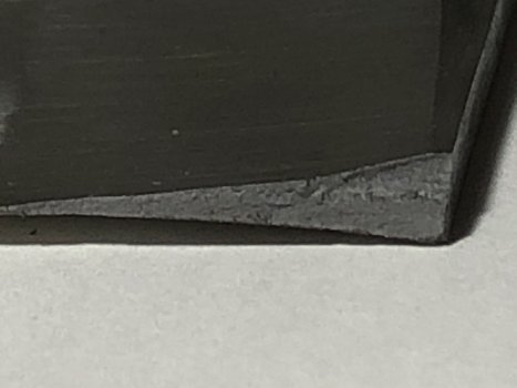

Fellow Knife dogs. Can anyone give me a little feedback on the grain structure from this breaktest. The steel is from an old buzz saw. It takes a hardening very well and creates a very flexible blade that comes back to dead straight. Do not know the hardness do to lack of hardness files.

I will try to get better lighting. I think what you are seeing is the pull from the break. 10min soak at 1500 degrees and quenched in Canola oil that was approx 130 degrees
To check grain structure, doesn't the break need to be untempered? Direct from quench. Best way to compare grain is to break a drill bit (or old file) and look at that grain. With naked eye there should hardly be visible grain structure, just a "gray" look like you see in broken drill bit.
A ten minute soak is a long time at 1500 degrees. Others may know differently but I don't think I have any carbon steel that requires a 10 minute soak at that temperature.
