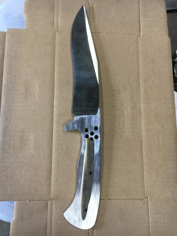

It will be 14" overall with a recurve to it. I'm going to use 1095 to make this so I can attempt a hamon. All I have for 1095 is 1/8" and 1/4", so I cut out 2 in 1/8" and one in 1/4". The 1/4" one I will Grind a distal taper and taper the tang. If I don't like how either turn out, I'll order some 3/16" and make another one.
Here's where I'm at so far. They are profiled and the faces ground clean. Next, I'll rough grind the bevels, drill handle holes and taper the tang on the 1/4" one. Then comes the claying for the hamon.

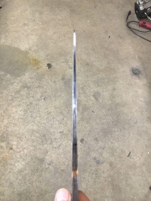

I was able to get some work done on the 1/4" bowie today. I'm going to hold up on the 1/8" ones as I feel 1/8" may be to light for a knife this size. I have some 3/16" material on the way ,so I'll catch a couple up when it comes in.

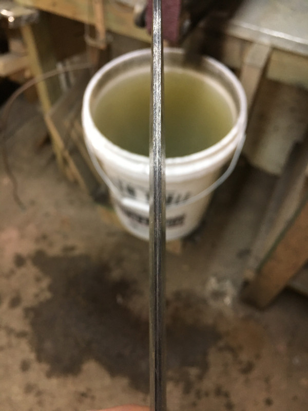

After drilling the holes for the corby bolts, I started on tapering the tang. First, I ground a trough in the handle through the end of the tang.
Then I ground the taper in, from 1/4" at the riccaso to .060" at the butt of the handle.

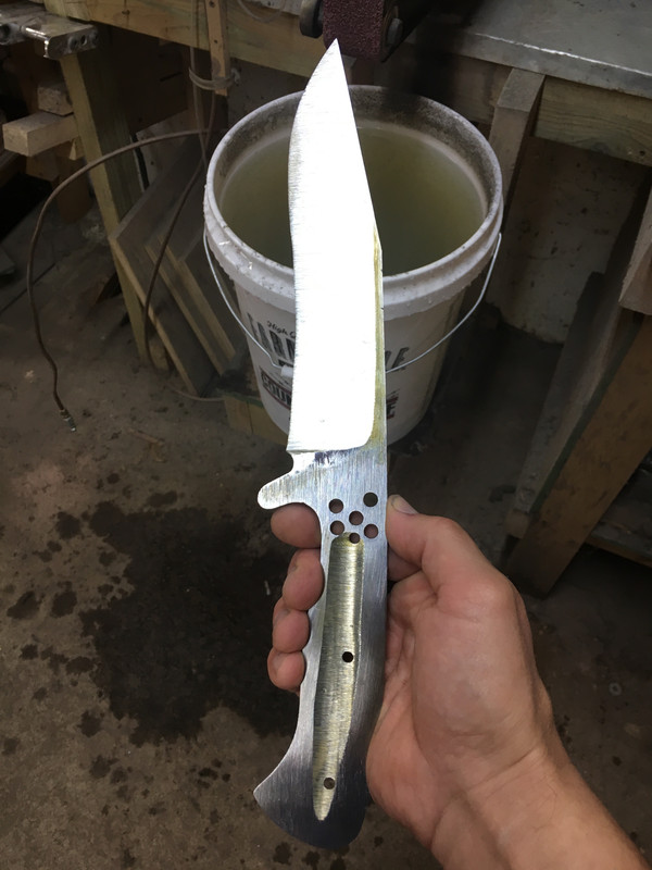

From here, I rough ground the bevels. Here it is at 36 grit.
And at 120 and ready to heat treat.

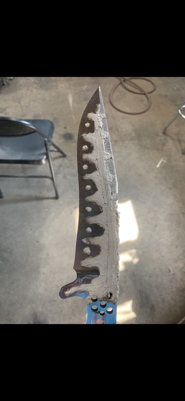

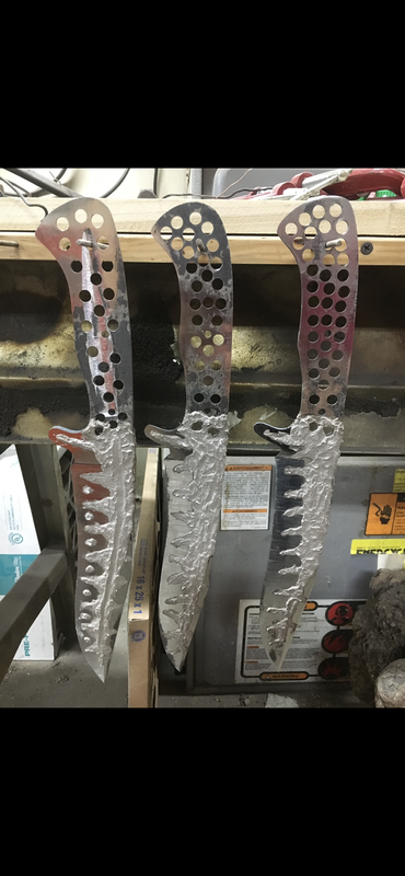

Next, I'll normalize, thermal cycle and clay the blade for the hamon.
