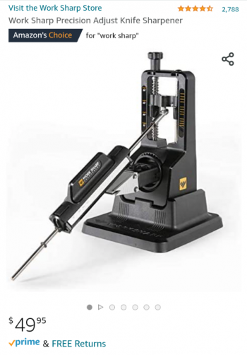

If you're making a recommendation to a customer, I think these are a great cost effective option.
Consistent results, minimal skill and minimal effort.
