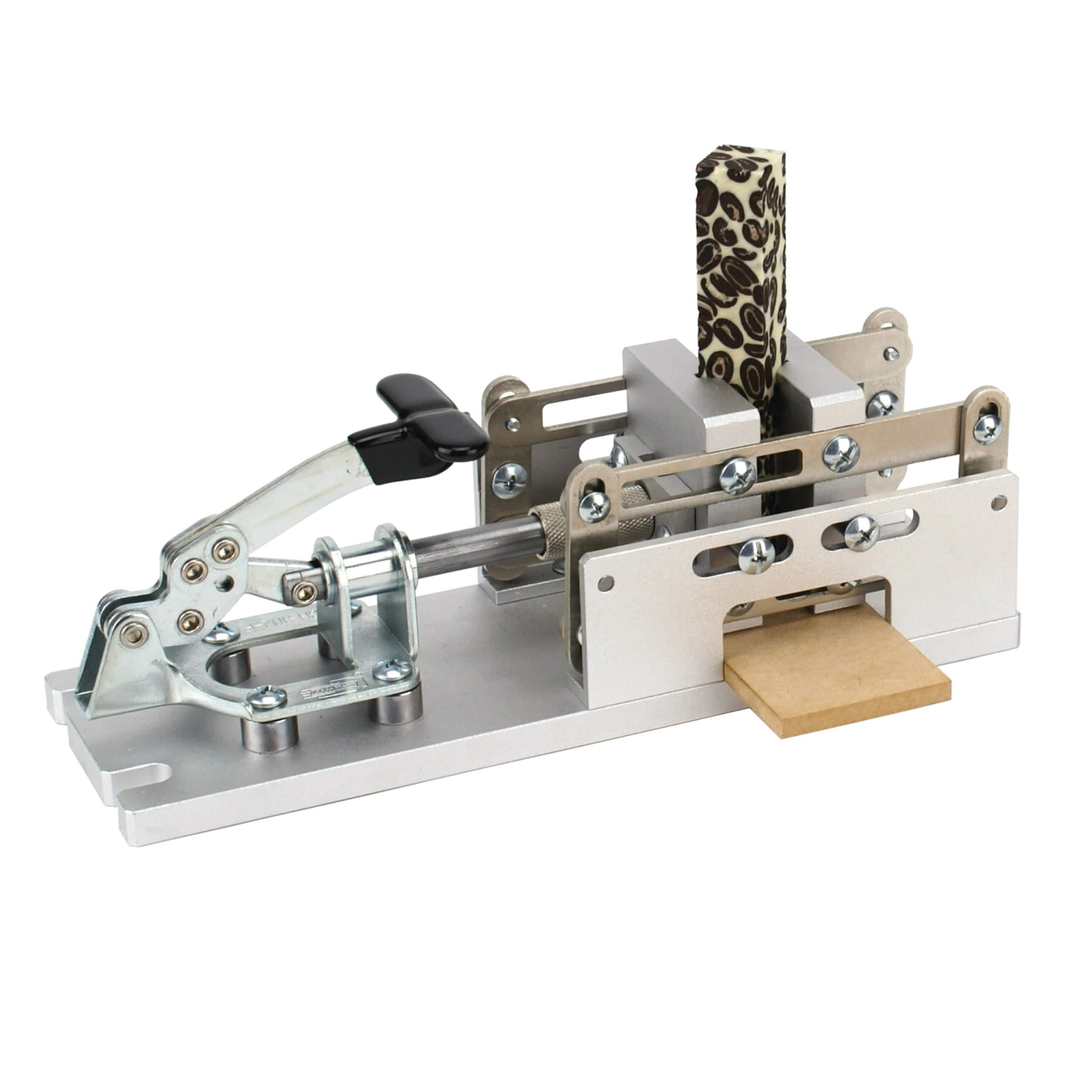

I use a spade drill bit and a pen vise for drilling wa handles. Dont use the screw tipped spade bit; they will pull the blank into the drill bit and you will drill deeper than you want really quickly.
I got this one a long time ago and there are much simpler ones too:

You're right a spade bit will do the job too. I'm not fond of those for long holes, to me they seem to cut too aggressively and with a small shaft may tend to wander more than a twist drill.
That pen vice is pretty slick, first time I've seen one of those.

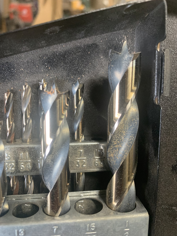

These are what I use to drill any precision holes in my handles. I always called them a Brad point bit.
I’ve never considered sharpening these types of bits, let alone making one from a regular bit. Great job!!

Gene: For me this is a case of getting locked into one way of thinking, seeing everything from a metalworking viewpoint. Of course your correct, brad point drills are used all the time in woodworking and many are ground similar to the sheetmetal drills I mentioned. What's kinda interesting though is that bradpoint drill references it don't seem show them being used for cutting sheet metal. But woodworking bradpoint drills have a reverse angle outer cutting edge and should be able to cut sheetmetal if the drill material is hard enough and the cutting edge angle is not to acute. For metal, the center tip (brad point) may need to be shortened and/or sharpened).
Thanks for the clarification, I see Amazon has a bunch of the bradpoint drills with various tip grinds.
