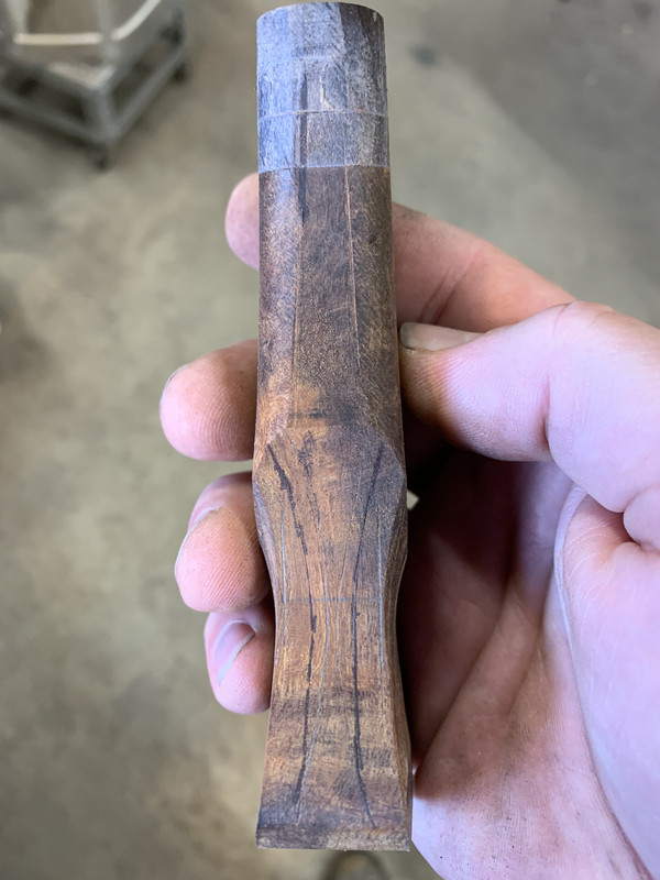

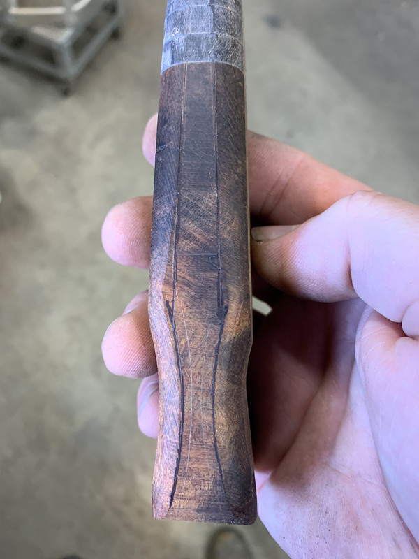

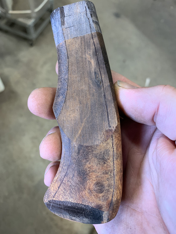

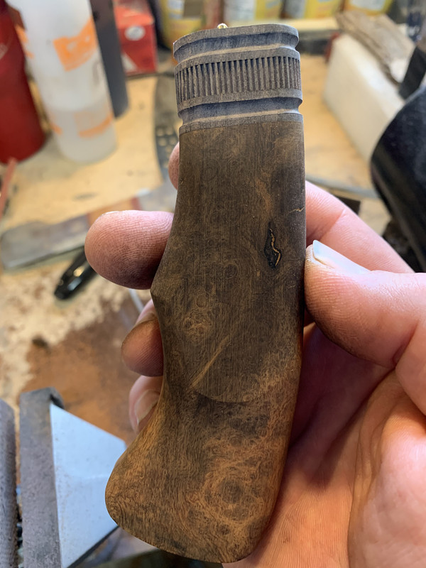

Making some progress on the handle and fittings this weekend. I did all the contouring with a rasp and sandpaper. I usually do most of this on the grinder but wanted to keep a specific shape and figured slower was better. I drew a lot of layout lines on the handle so I could keep everything even.

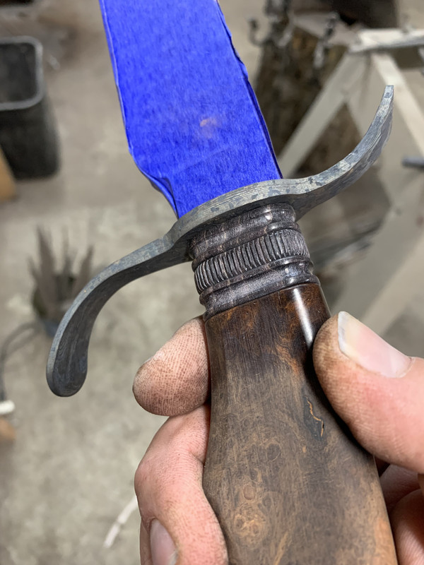

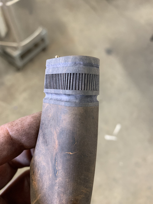

I spent a couple hours finishing the fittings. I'm pretty pleased with how they came out for the first time doing this.
2019-10-20-14-04-39.jpg Gene you knocked this one out of the park, with that combination. What are the spacers made from. I like that kind of (dusty look) for lack of a better terminology!!
The idea of the spacer in the middle with the notches sits the whole thing off!! I have been working on that idea for a while but laying it out and keeping everything straight and even is what really makes it look so good.
Is there a trick to that or is it just like everything else? Practice practice practice! I have attempted such in the past and either I need a bigger scrap bucket or more practice!!! :D
The spacers are quilted maple that has been dyed black and stabilized. I was hoping they would come out pure black, but I like this look too. I think they would look real good with wrought iron.

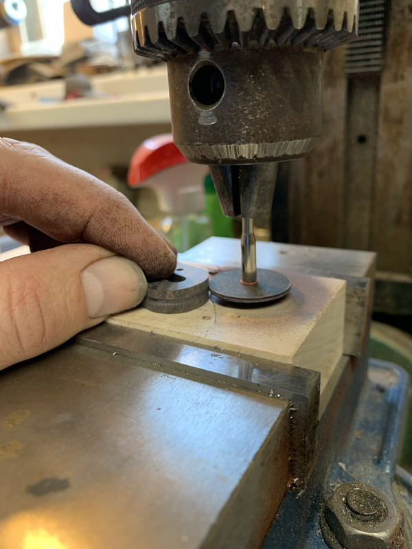

The center spacer was done with a checkering file then I rounded the edges over with 400 grit sandpaper. On the outside spacers, I used the mandrel for a dremel tool in the drill press with 2 cutting wheels on it to cut a starting groove in them. Then I scribed a line around them .065" in on each edge with calipers. I used a 5/32" round file to file the groove in between the scribe lines, then rounded the edges over.
