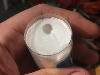

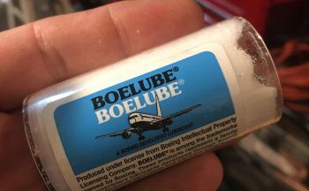

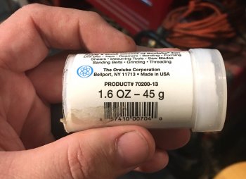

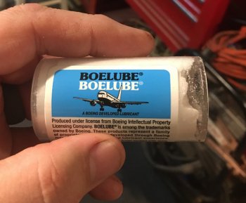

the Boelube i picked up from amazon is a tube of dry white compound. I also saw there are multiple options but this is what I got and I love it.
I’m not drilling 50000 holes per day so this ought to last me a very long time.

The Boelube I got is a pink, waxy dry compound. Not sure of the differences but the size tube John posted is what I have. It will last a LONG time.
I think I asked this one time before but what do you do just plunge the bit into it??
