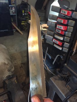

OK, I have made an executive decision regarding the design of my Bowie. I am going to ditch the D-guard because there is not really much of a demand for them in today's world and there are other, more marketable skills I could learn. Therefore, I have decided to do a framed handle instead. I have never done a framed handle and I think it would be more valuable to learn that than a D-Guard. It will not be a coffin style handle because I am not a great fan of those so I think I will just do a sculpted handle with maybe a cool pommel. For those of you who have made a framed handle should the internal frame only be steel or is wood an acceptable choice? Contrasting wood on the frame and scales may look really cool. I will post pics as I progress this weekend...Hopefully.
