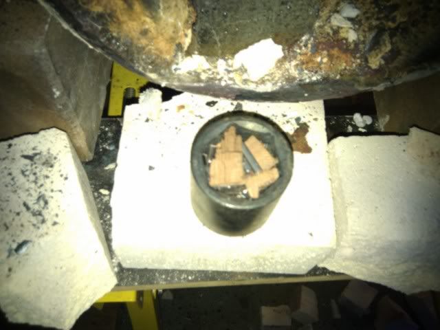

It's been a while since I've melted metal, so tonight I decided to melt up some for a bolster on a knife I'm working on. I had been reading on shibuichi, which is an alloy of copper and silver, and I wanted to give it a try. I've got some silver and copper squirreled away for the real stuff, but just for messing around tonight I used some silver brazing rod. It's 15% silver, with the rest being copper and a bit of phosphorous. My normal casting rig is more set up for casting alot bigger amounts of metal than what I wanted to cast, so I improvised. Now using steel for a crucible isn't the best option especially for copper alloys as the temp is high enough to make the crucible possibily fail, and some of the iron will dissolve into the melt affecting the alloy. But for something this small a really thick walled steel crucible will be fine, I'm not concerned with having a "proper" alloy as I'm just tinkering around here, so I used an old 1 1/4 shallow well impact socket that I welded up the bottom on. It makes a nice heavy walled crucible with a thick floor, once it's up to heat it stays there for a while. Here it is charged with all the brazing rod cut up and some hardwood for a cover.
