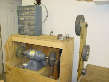

I built one of these for each of my buffers and they have been tested several times and work great.
-John
