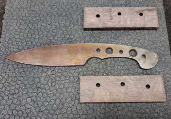

1084 Steel with Black African Hardwood handles. As of today, it's been heat treated, steel has been ground level to 220 grit (still more to go), and the handles have been cut to size. I hoped to be further along, but unfortunately after over 20 work related phone calls, I gave up for the day.
Next is grinding the bevels and shaping the handle.
Suggestions please!! I'm thinking of stainless pins? Does it need a colored liner for some pop? I was thinking a red liner and maybe a red center pin. If too much, please let me know your thoughts.

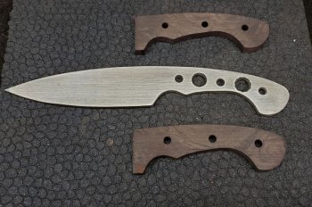

Got a little bit more done today. 1st pic - Started hand sanding one side of the handle. 2nd pic - shows the left handle shaped to 400 grit, the one on the right has not been shaped. 3rd pic - Shows the shaped handle on the blade. I'm liking the blue blade!! What do you think?

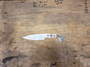

I didn't realize when I posted the first pic, that my 2 Harbor Freight anvils were in the background. Please don't be jealous!
Brad Walker
Well, the good news is, the handles are shaped to 400 grit. The other good news is the left side look pretty good. (not as good as it did!) The bad news is I chased a problem on the right side and I am not sure I can correct it. The left side was prettier before I attempted to match the right. I stopped trying and will get back to it. I seem to always have problems with the right side. Anyone else have that problem? If I can't fix it, I'll have to start over.
