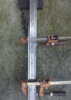

I'm thinking the best bet in fixing the bow is to heat it back up to it's original tempering (or even slightly less if possible) temperature while clamping (or overcorrecting) to a straight edge of some kind. Granted, this may damage/destroy the original handle which may have to be removed/replaced, but it should allow you to flex/bend the steel straight without as high of a risk of cracking or breaking the steel.

I removed the scales(G10) by heating em up a little in the oven to loosen the epoxy(300*F) and clamped the blade to a 1-1/4 steel tube(part of my 2x72 grinder's tool rest) and tempered it @450, this almost got it completely straight, I am going to use some 1/8" shims tomorrow and over clamp it a bit to get it completely straight. I am then going to rework the handle a bit and use stainless 1/4" tube for pins to give it a better look. The maker wasn't refusing to do the work but was pressuring me into getting him out from under another knife he had made for someone else that he needed to get rid of and that alone made me nervous.

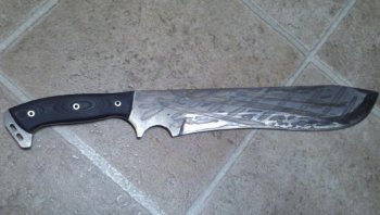

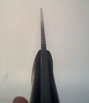

Well guys I got it fixed. First I brought the knife up to about 280-300 degrees in a controlled oven to loosen the epoxy on the scales and removed them and did away with the clear G10 pins. I then clamped the blade straight onto my tool rest for my 2x72 grinder (1-1/4" tube steel) and preheated the oven to 425 degrees to re-temper the blade. I cooked it for about 2 hours and allowed it to cool at room temp then cooked it again. Running 2 tempers on her seemed to relieve her just enough to allow her to stay straight once cooled then unclamped. Once I did this I took the blade to a medium satin finish using a scotch-brite belt on the 2x72 grinder and then reattached the scales using 1/4" OD stainless steel thong hole tubing and some 2 part epoxy. I then reshaped the handle area dropping the back of it about 1/8" and bringing the belly up a about the same amount to fit my hand better then took the edge off of the finger choil area and squared it off. After this I took it outside the shop and wailed on some dry fire wood I have outside for my smoker(stuff is ROCK hard) and it ate it up with no loss of edge, still shaving sharp. Once I was done with that I cleaned her up and put a forced patina on the blade using a simple yellow mustard coating. It turned out awesome and feels a lot better with the handle area slimmed down and I much prefer the pins that are in it now.
First pic is the knife the day I received it. The rest are the results of my work. Excuse the quality, Cell phone pics :(

Very nice job! It's a shame the maker wouldn't do the same for you, but chances are you did a much better job any how.
