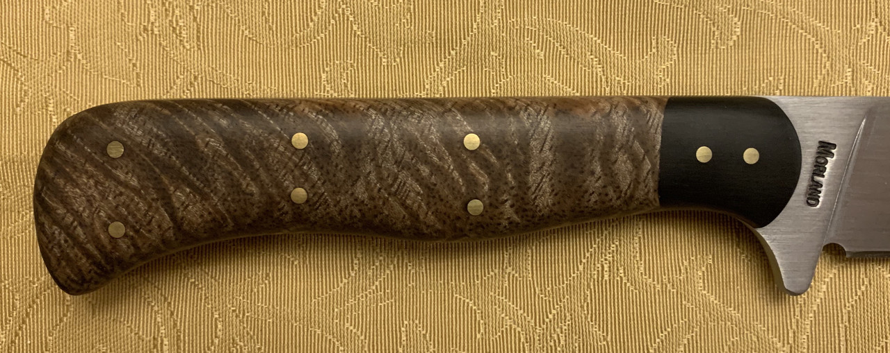

Dennis Morland
I agree with Ed. Blackwood does not take much for treatment purposes. On these knives the bolsters are Blackwood. I hit the scales and bolsters with tru-oil. The Blackwood does not absorb it worth a poo. After finishing, I use ren-wax and hand buff with a cotton cloth.
