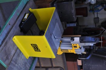

Here are some pics of my setup....
I have used no other saws for comparison... but I own the same DeWalt as Ed, and I have absolutely no complaints other than the throat depth. One benefit of this saw is how easy it is to mount vertically.

Here are pics of how I mounted mine! I removed the handle and made a bracket to take its place. The table is invaluable for cutting and it approx
De Walt with Swag Off Road mount. A welder friend has had one for years with no problems and hard use.

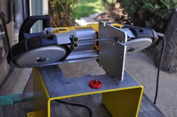

Here is my setup, Dewalt with the Swag offroad mount and foot switch. Both are new, Got the saw on e-Bay roughly 235.00 to my door,The Swag mount with the foot switch was 125.00 to my door. I like this mount because I can remove the red hand knob and use the saw in the regular mode.
