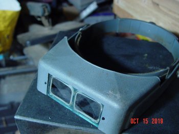

Real good directional lighting. Magnifier glasses. vise.
Don't forget - this is the way I do it. Not the right way or the wrong way - just my way. you'll end up tweaking your way as you progress.DSC01400.JPGDSC01401.JPGDSC01402.JPGDSC01404.JPGThis is a knife that I'm currently working on, so we'll use this as the model and go step by stepDSC01406.JPGMore tomorrow
