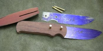

    Awhile back i was buying some knives from a guy on ebay who made these type knives. They were very reasonable and i used them to practice making sheaths with. Well he started selling supplies also so i picked up some sections of blade he put up for auction. Being fairly new at this i decided to try and make a few since it was something different that i had not tried before. I grind the sharp teeth off with a bench grinder first then take it to the belt. Getting that cut in the wood the correct size took a little practice also. These blades are about .060 inches thick and are very tough. Used a carbide bit for the holes. You can bend them quite some distance before the break. When i looked at the break the structure was very fine. Some pretty nice steel with minimal grinding to do for an edge. I will pass these on to some deer hunting buddies after completion. I have some knives i use in the kitchen with this steel and recently resharpened them with some Japanese water stones. They take on a nice patina and stay sharp for quite awhile. Another bonus is you do not have to heat treat either.

    Hey Franklin. Thanks, I know some people probably dont think to much of them but i am here to tell you they make excellent user knives. Teaches most of the basics also. I should have at least one finished over the weekend. If anybody out there wants to try one shoot me a pm and ill see if i can send you a section.

    I sure that they are blades that are for wood. After some testing i decided that they were not quite hard enough to use as is. Took care of that with an edge quench in oil and temper at 375 degrees before grinding the cutting edge.
