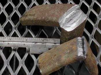

I have some similar. Have never done anything with it. Not sure if mine is welded like yours, but I cut and bended it and didn't get the typical wought, break.
I'll try and locate pics.

I posted these on "I FORGE IRON" a long time ago but nobody knew anything about it.

Mark mine looked like mono steel until it was etched .I'm not sure if vinegar will work i used ferric cloride. Are both pieces in the second pic from the same wheel? Give the vineger a try you will have to leave it for a while i think.

Two different wheels.

I'll go polish a piece and put it in some vinegar and see what happens.
I polished a piece and put in the vinegar.
Do I let it set then pull it out and polish again or no need to polish?
I soaked this overnight, not sure what I'm looking at, definitely not as defined as yours.
