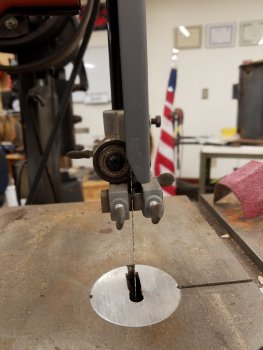

There's a guide for the blade that can be adjusted up and down. Set it so that it's close to the piece that's being cut while still being able to see what's going on.
I have a Craftsman bandsaw as well. If yours is the same as mine you should have a knob on the top that will loosen or tighten the blade. I can post a pic later if that will help
You have 2 good responses. Here is one more response for ya. Look at the photo Ty sent you. At the bottom of the guide you will see a few rollers or maybe a flat guide like mine. They too need to be adjusted to keep the blade inline.
Oh I think that might be the major culprit. I think I have a big space in there. I'll check tomorrow and also adjust the other response ideas.
