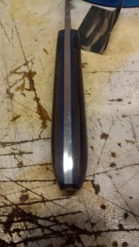

    After along debate my wife and I decided to invest in some equipment. She has always been supportive of anything that I wanted to do. Before knife 4 a KMG 3 speed was ordered. IMG_20160616_200125323.jpg This thing removes material fast. I wrecked the plunge line on knife 4. Again 1084 and Walnut from USA Knife Makers. IMG_20160707_170120452.jpg My brother wants an EDC so this one is going to him.
    My heat treating process is getting better. Knife 5 has the best edge retention of the 5 knives. 1084 and maroon micarta, black paper bolsters and blue liner. IMG_20160704_111657714.jpg Almost happy with this one. I still have long way to go. Thanks, Ty Adams

    Working on knife 6 has been fun. It has Dessert Iron
    Wood scales brass bolsters, and 1084. I really enjoyed the process of putting bolsters on this knife. But it will never get finished. My first try at bolsters did not go well. While hand finishing the bolster pins started to show. The more I sanded the more it showed that penning the pins did not make it all the way down the material. Not wanting the bolster to fall off I decided to chalk it up to a learning experience. So I did a rough sand to 800 grit, and did a quick buff. Thanks Ty

    It is not a complete waste of time. Your blade finish is improved. The outline of your knife is much better. In fact, I like the profile. The ironwood looks good. Pin placement is eye appealing. I would consider it a step forward. Overall, it is a nice knife.
    You will improve with bolsters/pins disappearing as you make a few more. Just keep swimming!

    You can put new pins in the bolsters on that first knife. Drill a hole in the existing pins on the side that is showing. Tap them out and re champher your holes and insert new pins , pien and grind off the heads, just don't grind too far this time.

    Thanks Calvin for the compliment. I had thought about drilling out the pins. I do not have a vise for my drill press so I did not have the confidence in drilling them out straight. I did take a punch and peened around the pins. I do not think that they are going to come off now. That knife will probably be the knife used for hunting this year. Ty
