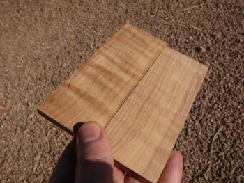

Here's an example of darkening - the piece on the left was neutralized only on the top after using AF - notice how the vertical face is much darker due to not being neutralized and then exposed to the sun:
To bring out the best grain heat is required - most folks use a paint stripper. The major reason is to make any remaining nitric acid more volatile so it will off gas, but it also blushes the wood and increases the chatoyance.
As noted above you can get virtually the same effect as Aqua Fortis aka ferric nitrate with ferric acetate, iron dissolved in vinegar, but due to the higher volatility of the acetic acid in vinegar there is no need to heat or neutralize.
