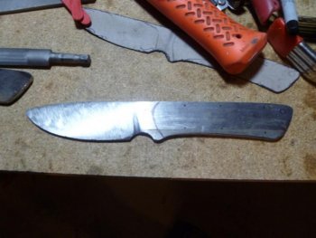

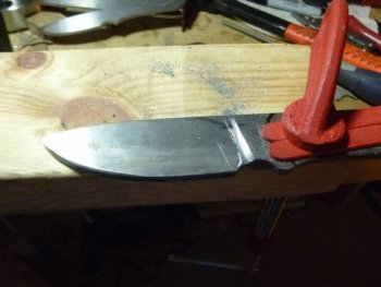

so i got all my profiles done on the bench grinder...been working on getting them squared up and smoothed out with the hand file...
today i wanted to hand file the bevel on my knife. half an hour yielded poor results ahaha. slow but sure, i'm in no rush

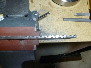

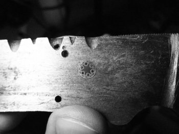

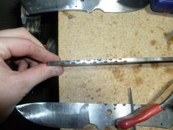

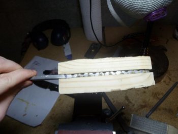

filework
did some filework on my knife to see how hard some different patterns would be and approx. how long it would take. this is an older picture, it needed touched up in some of the spots but i forgot to take a new picture.

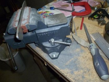

few updates. got hand sanding done on the profiles, have to do filework on top/ drill holes and grind the bevels and we'll be ready for heat treat. i'm moving along pretty well i think.
also another pic of started filework on another knife

also, i'm still kind of up in the air about using the checkering file next to the decorative filework. i'm not actually checkering, just making straight lines for grip (on top for your thumb). i dont know if it looks too busy or not? any suggestions?
Be careful about marking your pin and thong holes so close to the edge. If you run down into the pins when shaping/rounding the handles it looks stupid. Don't ask me how I know... Anyway I agree the profiles are nice, a good straightforward working knife.

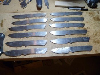

got some serious work done tonight
typical example of how much easier things are with proper tools lol. i got some of my stuff in, namely a norzon blue belt for grinding bevels. busted out the ruff cuts in all of them, and got them all to proper thickness. i'm going to go back this next week and hand file them to finish.

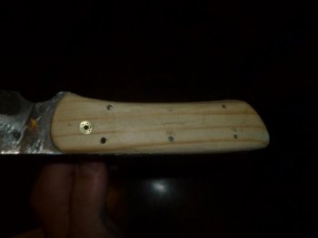

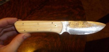

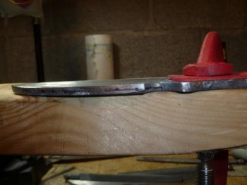

lastly, i ripped a couple 2x4 blank scales so i could sand out some mock ups and see if my pins were too close to the edge. worked out fine so i'm going to go ahead and drill all the rest of the blanks. may have to move the thong hole forward a bit, but we'll see.
here are some pics (i didnt sand the scale, just hand filed it to a roundabout shape)

You're looking better and better!! Can't wait to see the finished, polished product!
As far as the "pre-heat treat finish" is concerned, I will typically take my blades to at least a 120 grit finish, and try to remove any of the "factory finish" off of the blade stock. You also want to make sure not to take your edge bevel down too thin. Where the final edge is going to go, you want to leave somewhere around the thickness of a dime or so, if that makes sense. Otherwise you risk warping, twisting, or cracking your edge.
I'm really digging that overall knife shape... looks very functional and comfortable, but also very attractive.

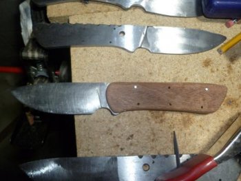

progress 2-19

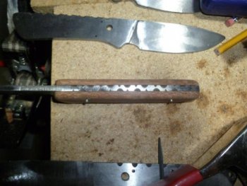

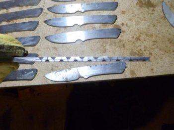

here is my knife with a semi - done handle. not final clear coat or buffed etc, but a general idea of what it will look like. this is leopardwood that i had left from that bow i posted earlier. I wanted to make it match the bow. also, a pic of the filework for the best man's knife. i wanted to make his stand out a little bit more. i think it looks pretty good for my first attempt at something other than alternating chainsaw files.

Nice work there, coming right along. File work looks might good too IMHO.
