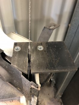

Have you got a pic of the work rest that allows for use in both positions Ian
Hope this works. It measures 100x75mm (4x3 inches) and you will note the corner is cut to allow clearance when in the horizontal position. Holes used are just the same ones that the original rest comes with.
