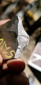

I believe that I read somewhere that canola oil will work, not sure it is the right one to use. I had a piece of 52100 that was given to me. I did a test coupon using the above recipe. I used canola for the quench, looks like it turned out nice. This is the coupon after breaking it. If i was using this steel i would invest in AAA.
