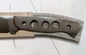

1) Are the liners made from three separate pieces or were they bonded as bought? G10 or something else?

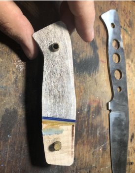

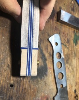

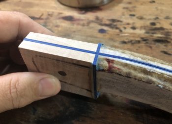

On each side between the handle scale and tang is three layers of liner. Blue / white / blue. These are the fiber liners. I use a hole punch to make holes in the center to hold even more epoxy.
Between the two handle materials I used two slivers of blue fiber liner. I usually use one sliver but the customer wanted a thicker blue line so I used two.

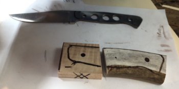

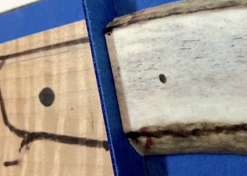

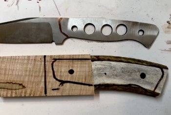

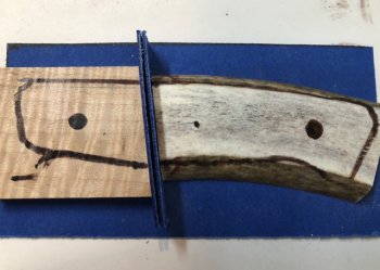

It’s easy as can be. I cut the approximate angle on my bandsaw and then use my grinder to get right right up to my cut line. Once you get a gapless joint between the two materials they will bond easily with no fuss. I like to put a liner in the joint for aesthetics and because I want to believe a liner with epoxy on both sides allows the two materials to shrink/expand at different rates without stressing the joint. That may be wishful thinking, I don’t know.
The other thing I do is to use a liner as a backer when I bond the two materials.

Here are better pictures to show the process
