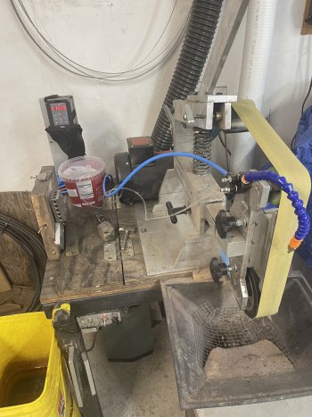

This week I put a mister assembly on my 2X72 grinder for cooling blade grinding. I've always avoided the mister in the past due to thinking there was going to be a real mess from the water. From reading on other sites and around I decided to give it a try. By keeping the psi down around 70 to 90 psi it works good and my dinky little 5 gal compressor seems to keep up ok. I put a gallon bucket about 3/4ths full of water and with a little grinding I find very little water is gone. The little clear tube goes in bucket of water, 8mm blue tube loops around back then to compressor 32 ft away (length of tube). Of course it's only used during bevel grinding post HT. Profiling there's no point.

![2x72-Mister.jpg 2x72-Mister.jpg](https://knifedogs.com/data/attachments/64/64649-2430285daee0d11288d9f647843bf6af.jpg)
