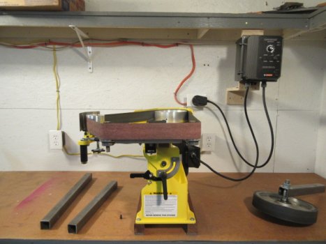

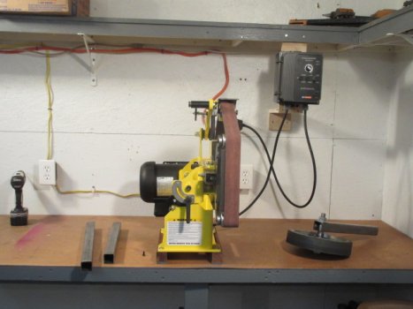

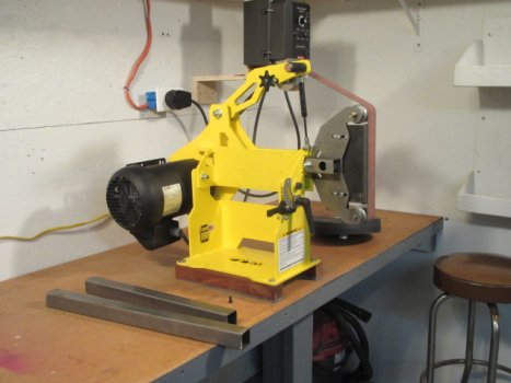

I have been buying from OBM for many years, I remember when they were called "Oregon Blade Maker". I have received excellent service from them over the years. I have also purchased many parts from them to build my own machines and I now have one of their tilt grinders that my wife surprised me with for Christmas this year.
I was hugely excited because I received a 2hp motor and VFD from them and I thought that was my Christmas present this year and then I found a tilt-grinder frame in the mail the other day that my wife surprised me with :) I just finished hooking up the power for it today. I had no idea that some people did not like the company but I have had very good experiences with their service for several years now. I won't know much about how well my new grinder works for a few months but I have spent the last week building a new work-bench to mount it and getting setup to use it. I noticed today that I need to make a couple of modifications to my current tool arms (shims and such) and fine tune the machine a bit, make a couple of new knobs that I will like better then the stock ones, dial in the tracking a bit, adjust my tool arms, build a new tool rest etc...the usual stuff one has to do to set-up a new machine.
It's no KMG but for the money it seems fine for a hobby guy such as myself, 2hp VFD motor, tilt frame and shipping cost me (my wife) about $1500.00. I would certainly recommend building one's own machine or saving up a bit longer for a professional machine such as a KMG grinder (or two) if I was using a 2x72 grinder to make knives for a living.
