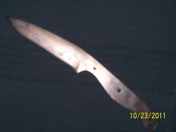

Ht'ing W-2 and Keeping the hamon off the EDGE!!!
Both sides look great to me Rex. They aren't mirror images but they are both nice in their own way. I'm sure you'll get the look you're going for after a few more blades.
Thanks Darrin,
I have learned so much from this knife it will be hard for me to let it go, it is my first successful Hamon on W-2, kind of a mile stone I'd say, I usually save my important (to me) blades like that, for gifts to those that have helped me, so I'm kinda undecided on this one right now. We'll have to wait until I get it handled, and some more testing done on it, so I can take away any doubts that it isn't dead on! Thanks Bud, I've got another monster blade on the bench now, in W-2 that I'm working on figuring out which way to take it, this one isn't as straight forward as most of mine, I usually start with something in mind or a sketch, this one was forged out kinda "will-nilly", I like to just forge a blade sometimes with no direction to see what happens, just start hammering, and shaping and go with what I see in my head, sometimes they turn out quite nice, sometimes they DO NOT! Thanks Buddy, Rex
Hitatsura is a type of Hamon where hardening spots are all over blade , The Japanese call it temper little bit all over ,
Look at this link and see if yours is a lot like this one ? go to link ,scroll to bottom go to far right , second from top.
I think it looks a lot like that one ?? I could be wrong . but, it looks good . Sori is curve of blade, Ishi are the little clay
lines that go from edge of hamon to edge of blade .

I think Ishi is what I meant, although I spent 6 months in Japan, I didn't pick up much of the language.
I have seen knives where their clay was what looked like stripes all over the place actually down to and covering the edge, which to me is kinda scary, I think it's different with higher carbon content steel like we use, I do believe that was Tama Hagne.

BTW I went to the web site you mentioned, that one is about the closest one of the bunch, mine has the blotches in the softer top side, the swoops going down have the blotches in it, it looks great...on that side anyway! I'll try it again, we'll see what happens!

Old knife....re-made new.
Confusing as that sounds, I'll clear it up. Here is the very first W-2 blade that I forged from some 1/2" W-2 I got from Aldo at Batson's in 2010, I forged this Blade shortly after I got this steel, not knowing everything that I should have researched before I dove off into it. Anyway, the knife is really nice, it turned out very thin, and I thought it would be like a scalpel, well the HT was dead WRONG, I didn't get a hamon, which didn't upset me....maybe a little disappointed, but the knife turned out so well I was
pleased right until I started sharpening it, I figured it would POP hair off my arm, shave slivers from newspaper. My first test was on my arm, it maybe got 1 hair, I think it pulled it out. Tried to cut some card board and it tore it. It was then I realized that the HT was done wrong by someone I won't name...since y'all know mine! :biggrin:
Some of you all may have seen it, I've posted it before, judge for yourself. I made this knife to fit in the side pocket of my carpenter jeans, as an EDC, I have decided to name it "The Pup", after, The Pup, Tyler, my son. Don't know why, it was more fitting before it would hold an edge!!! Here it is before the re-HT.View attachment 26909
So now that I know how to HT W-2, I decided to re-do this knife, I hated grinding off the Cocobola scales, but it had to be done and now happiness abounds in the McClellan Made Blades shop, Once I started the hand sanding, it was evident that this hamon was going to be INCREDIBLE!!!! I'll stop gushing now..just in case y'all see something that may not be right, so you all are the judge. Don't be shy, go ahead and tell me what you think. But try to be sweet, Please!
One more thing, I've decided to start making this knife and keeping some in stock, since everyone that has held it has loved it, Murph, I do believe I showed this one to you when you were here, John Sanford I do believe really liked it, I can't remember everyone that has loved the feel of this knife, it is easier to remember those that didn't like it, NONE! The new ones will be close versions of this one, as close as I can get forging, I have a few sticks of Aldo's 1/2" round bar still, we'll see if I need to buy more. I'm not sure how to price these, I guarantee they'll be very affordable, mainly because I want to get my name and my work out and in the hands of the folks that will be using them. So they won't be so expensive that you won't want to use it. Just a little heads up for the future.
I didn't have time to put the handle on so it's not finished but I couldn't WAIT to show you all this Hamon, I want to hear from Aldo and Bubba San! And of course everyone else, I'm so stoked about this knife, I guess you can tell.

I'll give y'all a hint, it starts with D and ends with amascus!!!!!! The first weld was 12 layers total of 1084 and 15n20. This 1st billet will most likely be ladder pattern and I may split it so I can do another pattern I want to try. It is incredibly exciting and I can't wait to get back to the shop. So with out further yapping,
I now present you with:
The Pup​
Looking forward to hearing what you all think about the hamon and the knife overall, it's now 2:21 and I have to get up at 5:30, so I'm going to crash, I'm so excited I don't think I'll be able to sleep! I'll have Hamon lines dancing in my head, with my mind racing to come up with what I'll do NEXT!!!

That Hamon is killer, striking, I love it . You really hit it !!!! Most of my better work is on smaller blades , them big ones are a tad bit harder. Please send me what info you have on ST-6 . I have been out of the loop since 1994 when I retired from Navy. Send to berryman@socket.net .Or I can call you . I personally think about 50 megatons would settle our terrorism problems .no mess no fuss and no dead GI's
