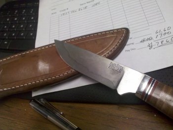

Here is the "NO CLAY" hamon that I made with the W-2. It was a full quench in ATF. The blade was ground to about .210 before we started grinding the bevels. The Hamon came up about .320 on the edge and back about .650 off the tip. "NO CLAY"
Rex , I don't think you have anything to worry about ! from what I have seen of your work . We all have failures occassionally. although I messed up 4 swords in a row , until I finally got one right . I was ready to stop doing water quenched blades . Ill bet your blade turns out to be a beauty .And Aldo you are pretty good !! looks like one of stewarts blades .....
Actually it's the only Bark River Bravo-1 ever made with W-2 and a stacked leather handle. Please don't ask BR dealers for it. It is definitely a 1 ott.
