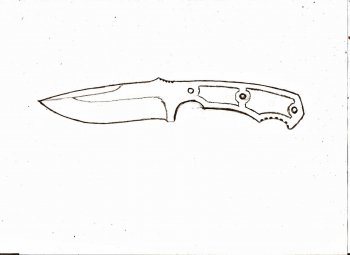

Someone say tanto? this is one that I built this summer, and would like to put into consideration. I am open to tweaking the design a little here and there, but I like this design. :)
In the drawing, I noted 8-32 threaded holes, and no, my CF tanto does not have them. But I have done one almost just like this with a drop point and bolt on only scales. I REALLY like the bolt on option. I wonder if there a good solid SS bolt with a flat head slot, to allow for easy in-the-feild breakdowns in case it gets soaked or whatever...?

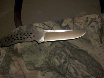

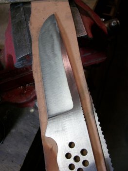

well ill throw this one in im building for a ranger cant see but has a skull crusher on back, jimping on top and 4 1/4 blade and im in on the build just let me now how were doing it great designs guys
