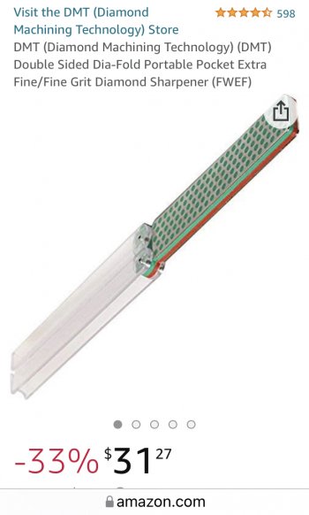

No matter which route you take, one of these belongs in every toolbox, tackle box, glove box, or bugout bag on earth. It’s too cheap not to have and works like a champ. Is it going to replace bench stones or a belt sander? Of course not. But I can put a shaving sharp edge on a busted a## beater knife in minutes. For a good knife, just a few swipes will bring back a hair popping edge.
DMT Diafold in fine/extra fine. About $30 on Amazon. It’s about 4 inches long when closed.
